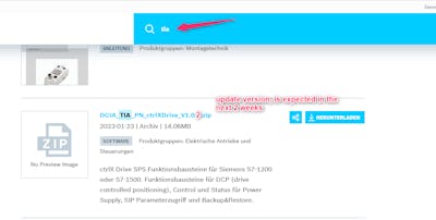

Example Siemens PLC available, SIP function works with ctrlX Drive and IndraDrive.
https://www.boschrexroth.com/de/de/search.html?q=tia&lang=DE&origin=header&num=10&s=download
