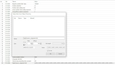

P-0-0300: I/O Engineering startup parameters
I would like to set the parameter P-0-0300 by I/O Engineering  startup parameter.
i used a syntax list as shown in the attached screenshot.
My problem is : the drive doesn't switch to OP mode  when i add this line in the list of parameters.
I dont' know if the syntax is correct or not, are there any solutions to this problem?
thanks a lot,
Could you tell us which device you try to write this parameter to? It looks like some drive (HCS) but not an ctrlX IO. So I can move it to the correct sub forum.
P-0-0300 is a 4 Byte variable list so parameters would be e.g.
  • S-0-0402 = 0192HEX = 16#01, 16#92
  • P-0-0223 = 80DFHEX = 16#80, 16#DF
We will check this in the next days.
