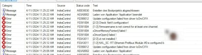

Running IndraWorks 15V18 with the latest firmware and have the following error when using a Realtime ENIP scanner extension module on XM22. It cannont find the driver.ย
I found this was a problem specific to 15V18 firmware. When I swtiched to 15V16 or 15V20 the problem went away.ย
