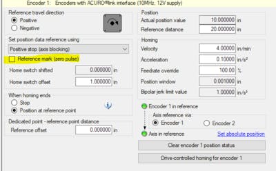

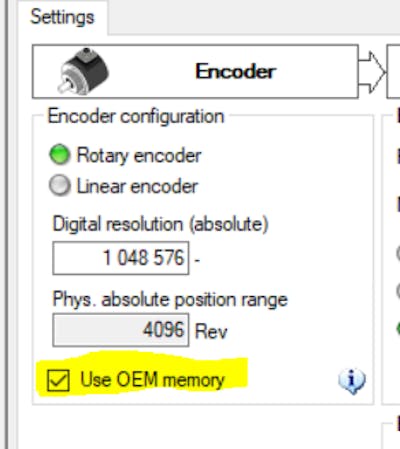

I have an application with a few drives and they all lose home almost all the time after a power cycle, or on IndraWorks switching to parameter mode and back to operation mode. I have the help files installed but was unable to find anything about a paremeter or setting I can enable to stop this from happening. The homing process is just jogging to a hard stop and setting the home position then. I saw a few things shared below that I was wondering if I should change/what they actually do.
