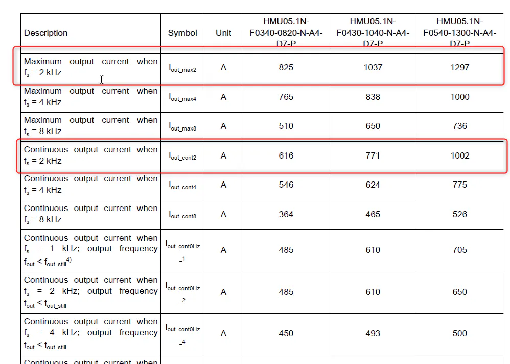

In our ML project manual, there is the rated and max. data with 2kH. Is this means we can set the ML PWM to 2kHZ for normal operation in our engineering tools?
