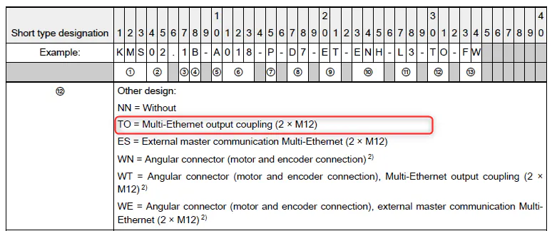

In an KMS02 with "TO", is possible to communicate with IndraWorks Ds to the drive through the connector connector X108 (as with configuration "ES" to connector X118)?

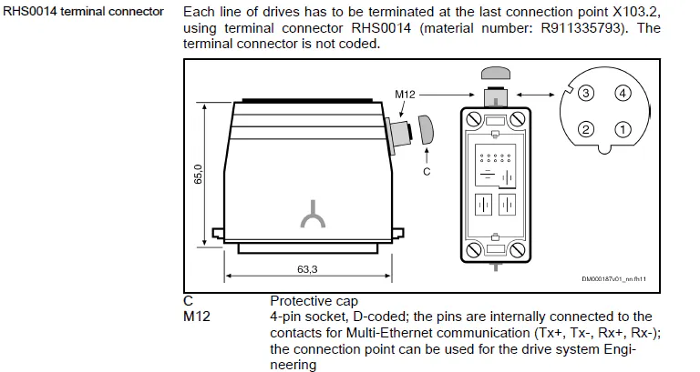

In this case, what happens with the M12 connector of the terminal connector?
