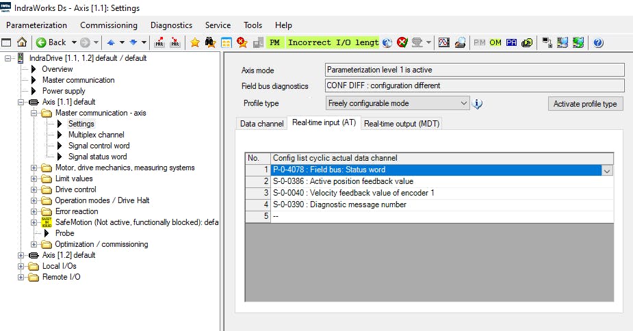

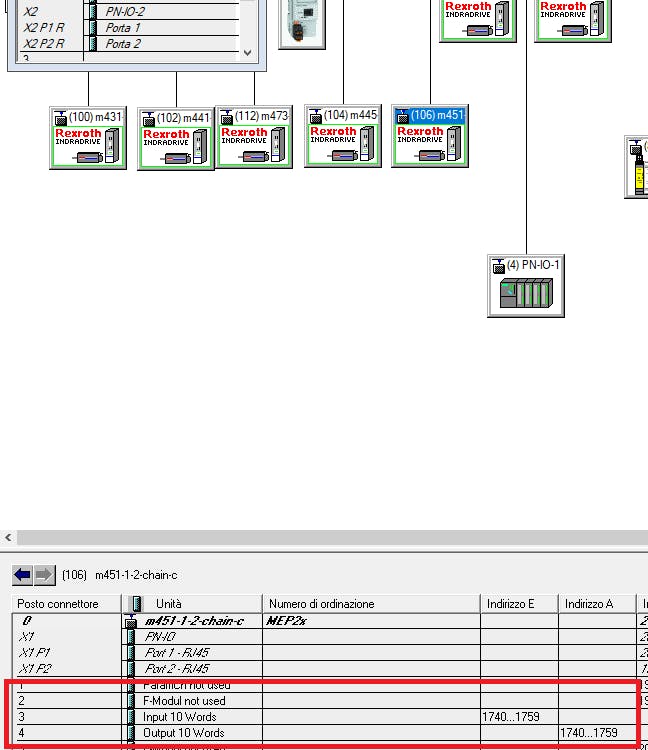

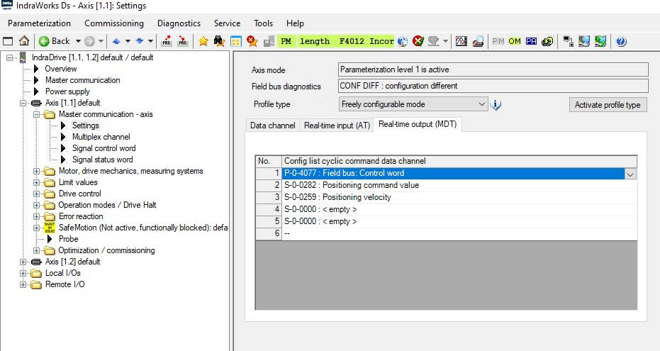

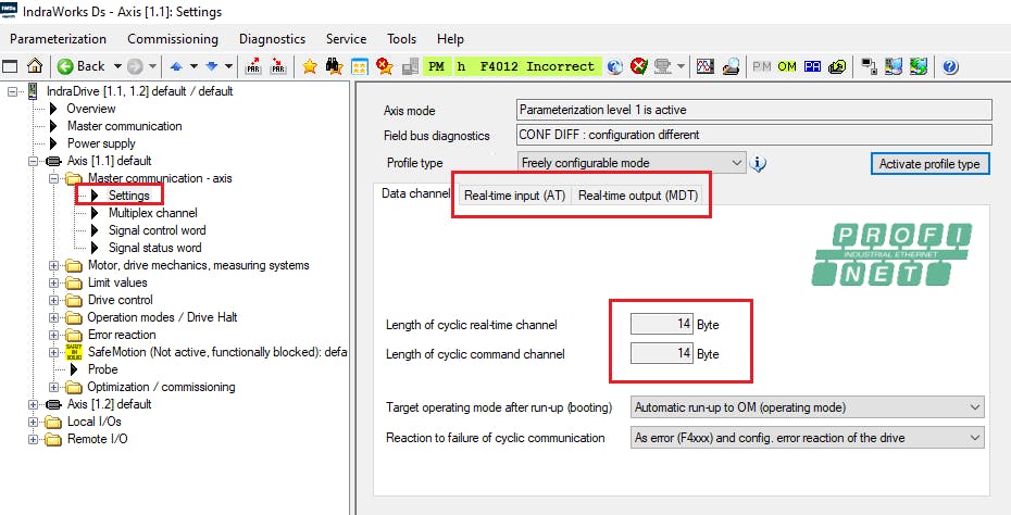

check the configuration word (master communication -> setting )drive side and in the plc S7-300 hardware configuration.
The number of word must to be the same otherwise you have F4012
error.
