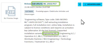

Best reply by CodeWasi
Hello AndreiMartin,
have a look for Indraworks ML... shall be visible under the link I sent.
The control-hw L65 you mention will be covered by that engineering suite. IW-DS just covers the Drive-setup.
If you are not familiar with the IW-Engineering, please watch out for the included IW-Help documentary.
