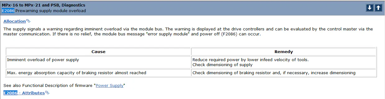

And, at what % is the power supply sending to the drives the warning E2086?
Thank you,
