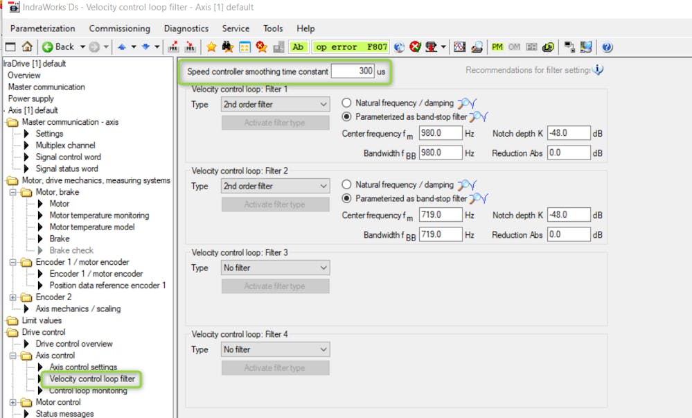

Driving a third-party linear motor, if it works for a certain distance, an error F8078 will be reported.
Have you ever encountered such a situation.
This indicates a problem on the mechnical side that you need more force at the position where the error shows up or the encoder has certain problems to provide the right signals.
Anyway I guess that you should increase the parameter P-0-0004 (speed controller smoothing time constant) from 300 us to a higher value like 2000 or even 4000 us.
Best provide a frequency response analysis of the speed loop:
If you never used this function before you can follow the How-To: LINK
