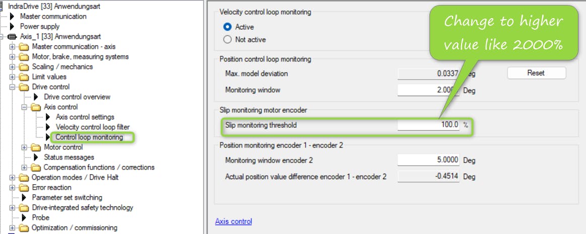

The error F8023 is telling the following:
It could be hopefully overcome by changing the parameter P-0-0520 as told in the manual. See:
