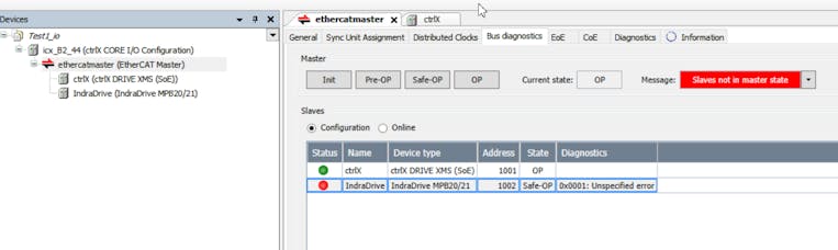

I am testing with a CtrlX starter Kit version 1.4 and would like to use the Ethercat Master with the HCS01 firmware 20.
I have configured the Drive as a slave to Ethercat SoE, and I have added in the CtrlX I/O repository the thercat xml for CS control cards.
CtrlX I/O recognizes the Drive when scanning the devices, but then an error occurs when passing OP.
Could you tell me the necessary configuration of ethercat for a HCS01.

Hello David08,
could you please try the setting just changing the Distributed-Clock to freerun-mode.
