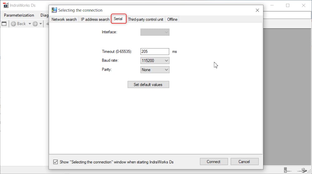

The USB connection and other serial interfaces are not part of the ctrlX DRIVE engineering but only in IndraWorksDs:
IndraWorksDs serial connection

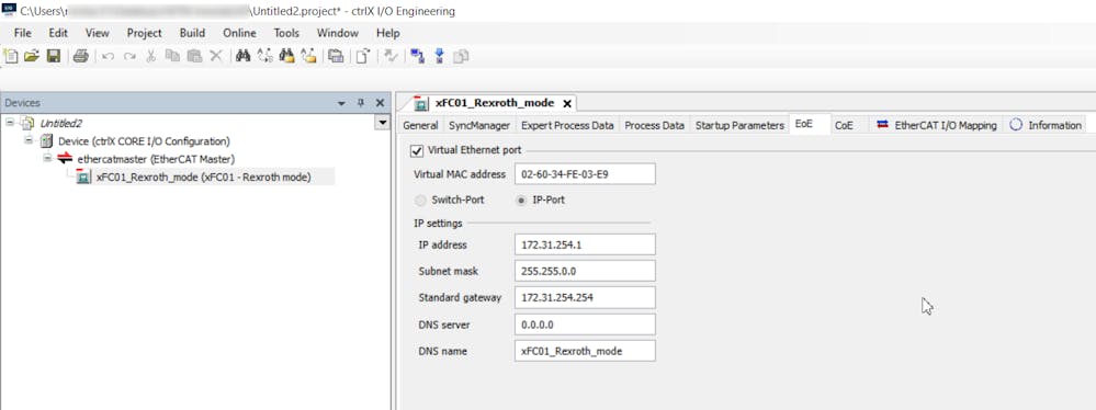

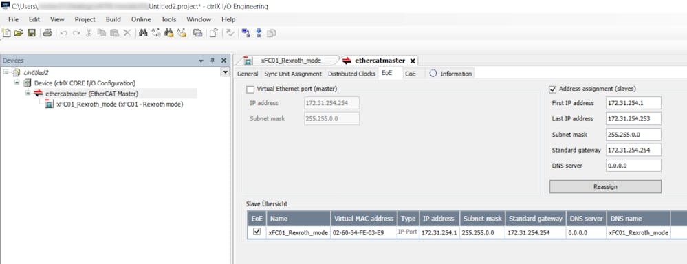

You can connect via EoE like you also do it in ctrlX DRIVE or Indradrive by switching the setting on in the expert settings of the master and the slave:
ctrx IO Engineering master EoE settings
ctrx IO Engineering slave EoE settings
