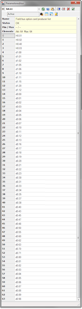

You can only transmit the parameters listed in b8.61 = P-0-1054.0.61 = "Field bus option card producer list" even if you can configure it in H3.31. The parameter groups b2...b8 are internal parameters and can only be found in the drive engineering tool. The listed parameter may vary between the different firmware versions so please check at your device.
EFC cyclic producer list B8.61

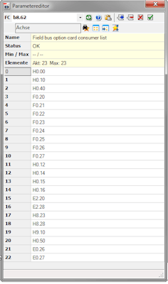

The parameter that can be written you find in list b8.62 = P-0-1054.0.62 = "Field bus option card consumer list":
โ€ƒ
EFC cyclic consumer list B8.62
