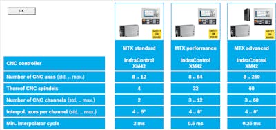

Generally we use with XM42 the same plattform for scalable solutions for MLC and MTX applications.Β But you can't mix it by choice. It is also related to the MLC or MTX system-firmware and the performance classes ff. E. g. none of the MLC controls can ever be used as MTX control. And a MTX-Standard is a MTX-Standard etc.; overview see below
