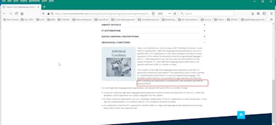

Customer has some extracts from below link
https://www.boschrexroth.com/en/xc/products/engineering/opencoreengineering/the-features-of-open-core-engineering/open-core-interface/open-core-interface
