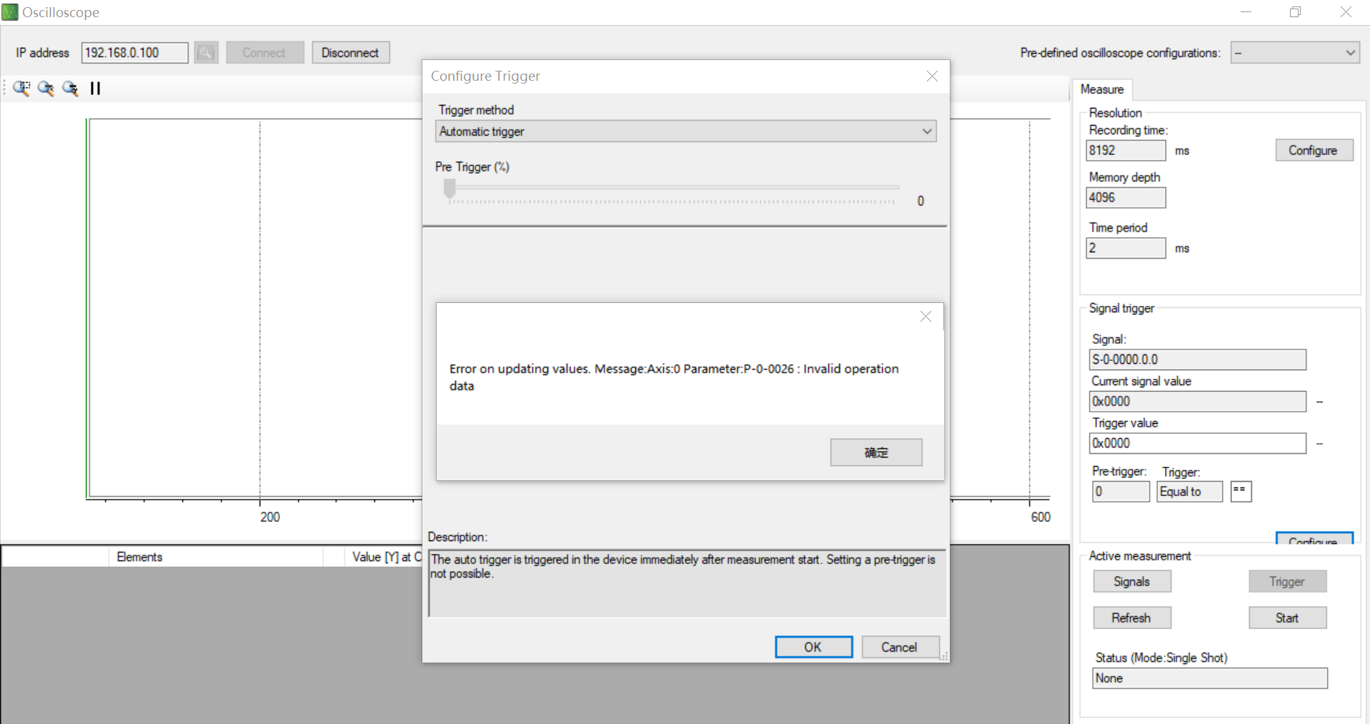

I try to implement the oscilloscope function based on the EAS sdk using c#, everything works fine until I met a question about the oscilloscope trigger

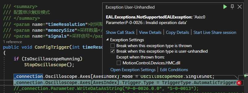

according to the EAL example, I try to set the automatic trigger mode, but come out with a problem, as attached
something like "Parameter: P-0-0026: Invalid operation data"
later, I try to use the executable demo in the example folder, it is the same problem.
But if I try to use the Indraworks DS, everythins works fine.
could anyone give me some advice on this topic? thanks

are you using the latest version of EAL (2.3.0).
I was using the latest version and I do not get this error when using "automatic trigger" mode.
In your case something goes wrong with P-0-0026. Whats the value in this parameter?
I would suggest to do a "load basic parameter" to reset your drive settings.
Please send me a parameter backup if this issue still is present after a reset.
