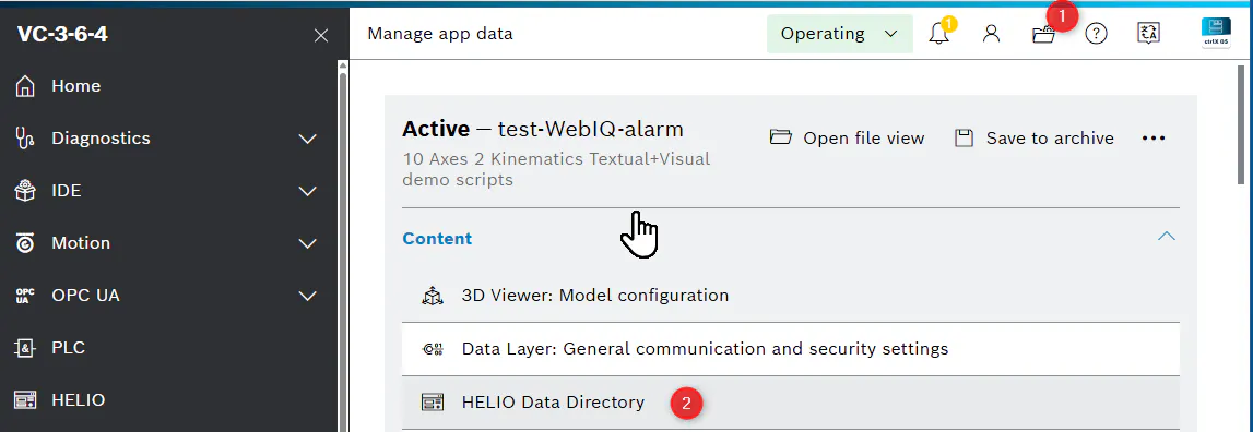

  • Log In to ctrlX WebUI
  • Click on icon "Manage app data" (1)
  • Click on "HELIO data directory" (2)
  • The data direcory of HELIO is displayed

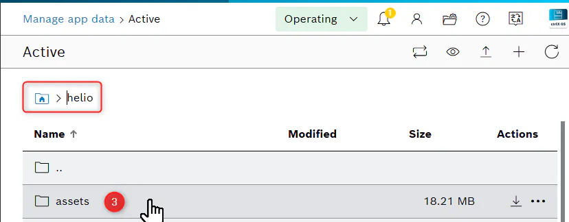

  • Click on "assets" (3) to open folder

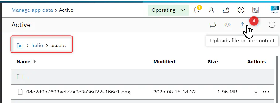

Click upload icon (4) and select the file to upload
