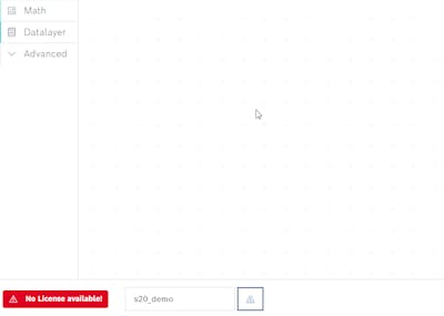

I am not able to run/compile any project in the Visual coding inside IDE App due to an error message of "No License avaiable". Also Textual coding is not booting up.
Things I have tried to resolve the issue but nothing worked so far:

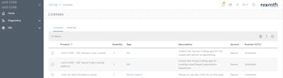

My System Info:
  1. ctrlX Core image: v1.20.5
  2. IDE App: v1.18.37 / v1.18.29
-> License file is accepted by the core
Any ideas how to fix this? Thanks for help.
Is your system time set correctly? Did you try do empty your browser cache or use a private tab in your browser?
Is there a ctrlX Python Runtime installed on your system, if no, programs will not be able to run. Also it can cause issues in the IDE app.
Also a missing ctrlX MOTION can cause problems in this versions of the IDE app.
