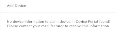

I am trying to connect my CORE to the device portal.  I have applied for access and have been granted access to a tennant (SPS2019).  In the email granting access, I received no further information than the tennant name.   I cannot add a device in the Device Portal because it requires a Connection Identifier.  From the Device Portal manual, it seems that I must obtain this Connection Identifier from the CORE itself.  In the manual, it describes a process to connect the CORE to the Device Portal.  The first step (chapter 4.1.3) is to accept the Service Terms, but this page never appears.  I only have this message:
There seems to be no way around it and I cannot perform the rest of the steps.  Because of this, I cannot add the device in either location: the Portal or the CORE.  My CORE has an internet connection.  I have tried both the Bosch network, and an open connection.  I see no errors or warnings in the Diagnostic log.
How can I connect to the Device Portal from this state?

Update:  The proper certificate and keys were located in the Settings -> Certificates & Keys -> Permanent Storage location, just not the Remote Agent section.  Upgrading the system to RM21.03 system apps triggered the software to move the Remote Agent certificate and key from the Permanent Storage location to the Remote Agent location and then the app functioned as expected.  It might be that only the Remote Agent app needed updating, I'm not sure.
