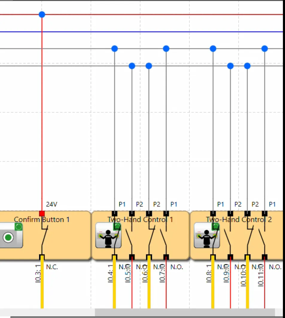

Inactive buttons (Two-Hand Control 1):

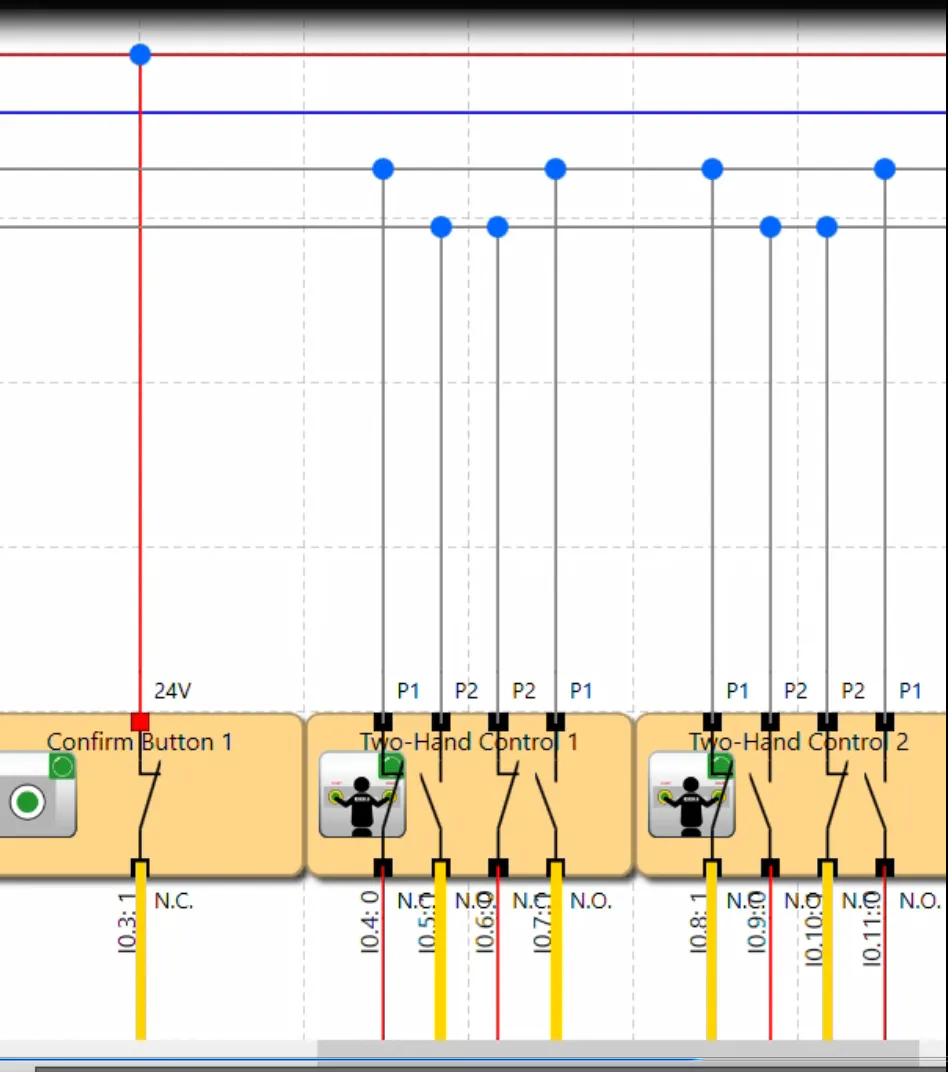

Pressed buttons (Two-Hand Control 1):

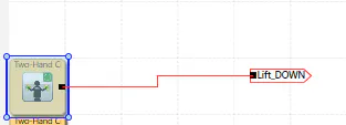

No signal (Lift_DOWN):

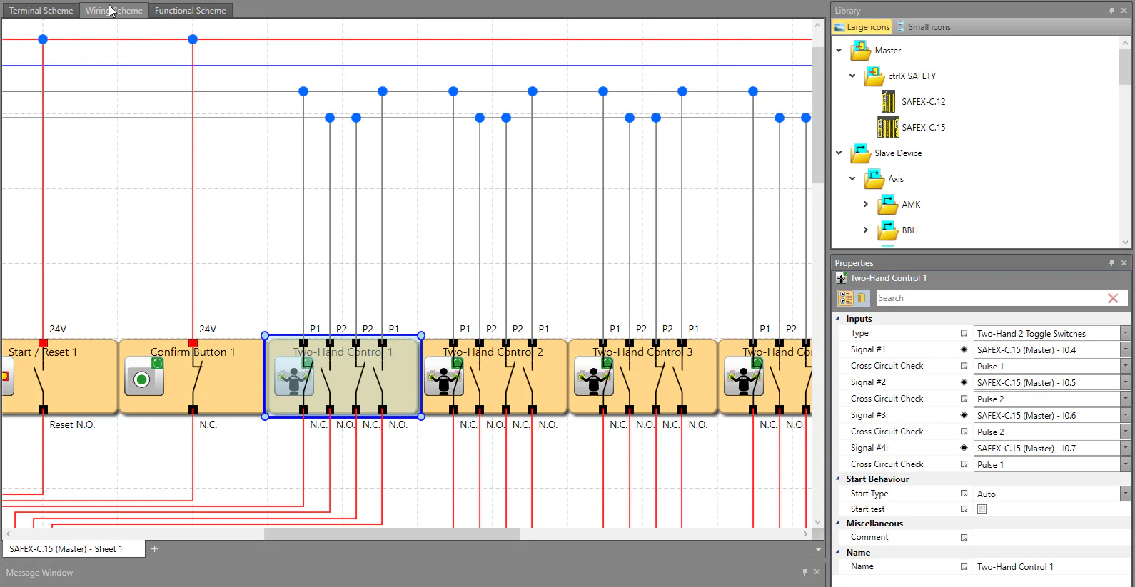

Settings of the (Two-Hand Control 1):

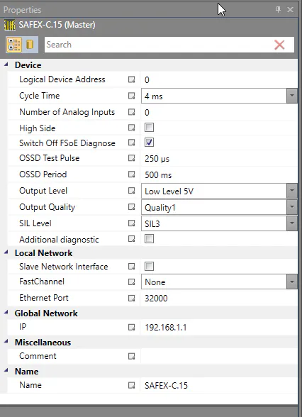

Settings of the ctrlX Safety 15:
