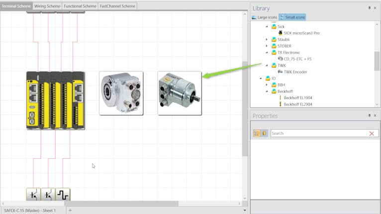

2. SAFEX-C.1x being an FSoE-Master needs only dragging-in of the FSoE-Slave device from the library into the Device/Terminal Scheme
In the case above the first two FSoE Slots in the configuration of the SAFEX-C.1x are used by the two devices shown here.

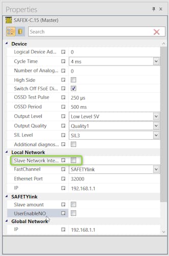

3. SAFEX-C.1x can be an FSoE-Slave itself in parallel to EtherCAT-Slave and FSoE-Master just by hooking this functionality in the controller's property dialog.
