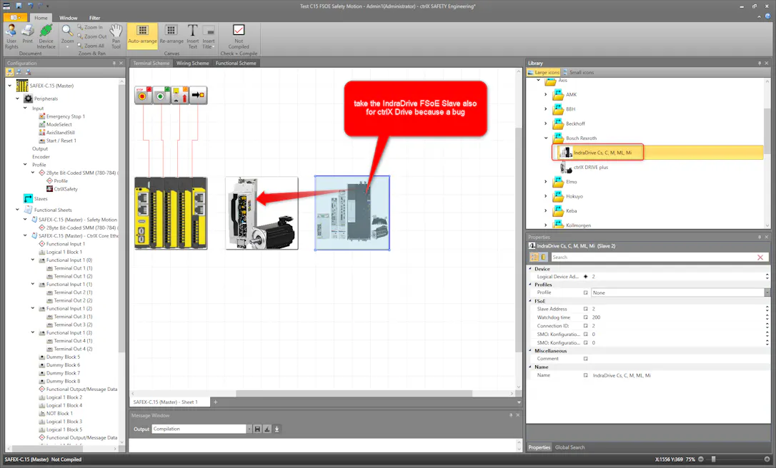

I set the communication as you can see in the attached files but the safety sytatu of the drive do not change even if I set the safety bit commands
Why even if the safety bit of the the 2Byte Bit-Coded SMM (780-784) (Slave 1) function are true the drive safety status is still EMERGENCY STOP ??
Why in the C15 status bar I have the message: "RunIntern" as shown in the pccture above?
What am I missing ?

because a bug please choose also for ctrlX DRIVE the IndraDrive FSoE Object
