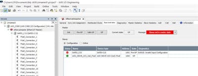

(1) I am trying to add my SAFEX_C15 into the IO Engineering app and i have below error. I found similar problem within community but still i am not able to get a rid.

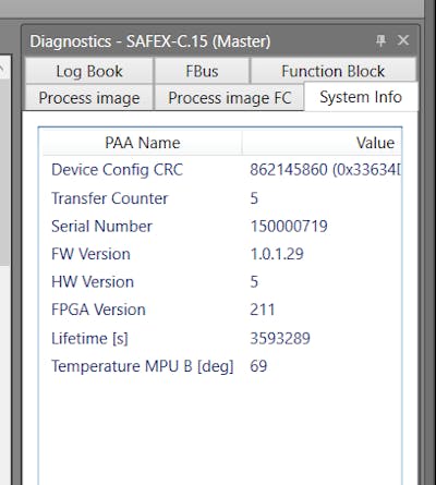

below is the system information for my ctrlX Safety engineering App.

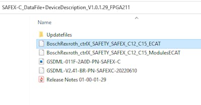

I uploaded already below ESI file in the IO App version 1.18.
(2) Because of this error i am not able to add SAFEX in PLC data layer?

I uploded both ESI file in IO Engineering app as shown below.
and upgraded the version of ctrlX work to 1.20 and now everything is okey in my case.
