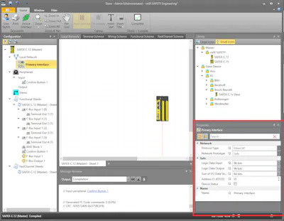

I’m trying to setup an FSOE connection between two SAFEX-C.12 cpu-s. I managed to setup one cpu to be the master on the network. The cpu status is RunIntern with permanently illuminated yellow light. That cpu is waiting for slave device connection.

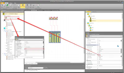

I tried to setup the slave device, but I don’t find any parameter or option to do that. I found WEBINAR snippet about this topic (link down below). Where the connection is established between two SAFEX-C.15 cpu. But I found difference in SAFEX-C.12 and SAFEX-C.15 parameters.
Β
It looks like in SAFEX-C.12 cpu I can't set any paramter to be an FSOE slave. I'm looking for any help to find where find such a parameter.

Best reply by AllAutomation
Hello CsTemesvari ,
as you said you are using a TwinCAT FSoE-Master. In this case you find the description to setup an FSoE-Connection in the Installation Manual:
HTH
