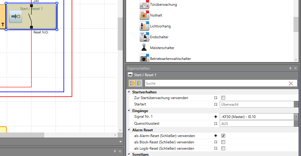

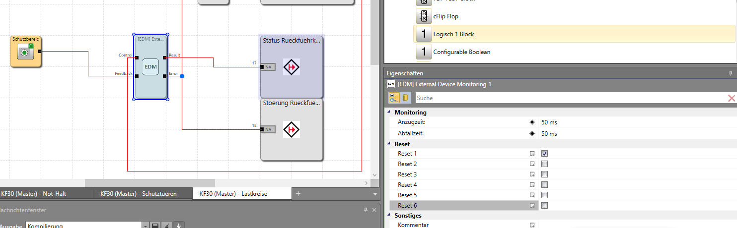

I want to use the EDM block of the SAFEX-C.12 for feedback loop monitoring.
Yet I am not able to Reset the Error of the EDM Block via external Rest.
The actual settings/wirings/interconnections are shown in the pictures attached.
Am I linking the external Reset correctly? Any thoughts were my mistake could be?

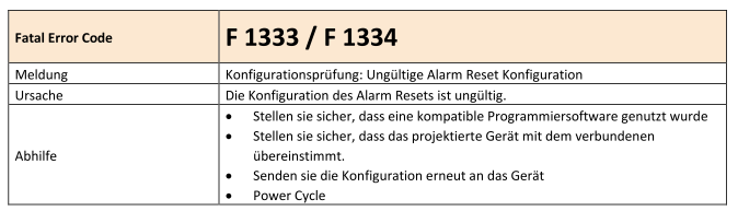

By the way, if i use the setting "als Block-Reset (Schließer) verwenden" in the Reset properties, I get Error F1333.
