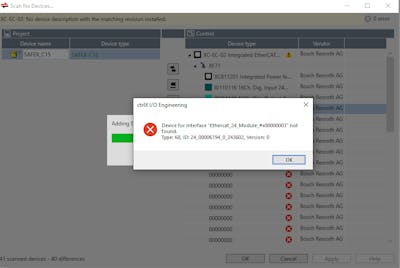

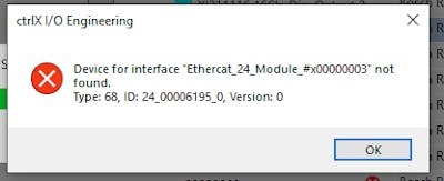

Following errors appear when adding Safex C15 to device tree in I/O engineering. Safex will appear to Core, but it is in error state with status "0x001E: Invalid Input Configuration".ย
I updated my Works version from 1.12 to 1.14 and atleast offline configuration in I/O Engineering seems to work now and there is no error messages caused by missing device interfaces.ย
