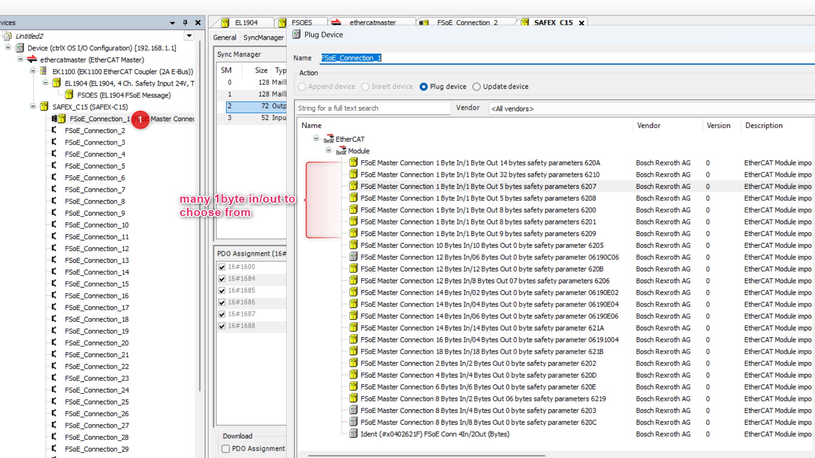

EL1904 Configuration
Does anyone know what the proper configuration is for a EL1904 Safety Input card connected to the SafeX-C.15 should be?
From what i see, it should be 1byte in /1 byte out as a plug for the SafeX, but there are multiple different targets to choose from:
