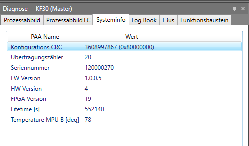

I'm trying to compare the actual CRC checksum of my safety program with the sum shown in my validation report.
Yet, I somehow cant find it in my offline program nor online on the controller.
According to the documentation i would assume to find it underneah the Configuration checksum in the Diagnose -> "Systeminfo" as shown in the picture attached.
Thanks for your support ๐Ÿ™‚

Hello MST,
now I understand. You see a mismatch between documentation and ctrlX SAFETY Engineering or the behaviour of the SAFEX-C.1x.
You refer to the Program CRC. This is a remainder of earlier versions. It does not exist anymore. It will be removed from future documentations. There is only one CRC, the device config CRC!
Your ctrlX SAFETY team
