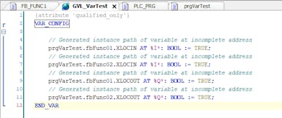

I'm trying to generate a variables configuration as explained in codesys help for variable with incomplete address.https://help.codesys.com/api-content/2/codesys/3.5.12.0/en/_cds_variables_configuration/#id1 .

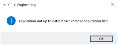

But when I click on Declarations > Add all instance paths (Step 6), I get the error

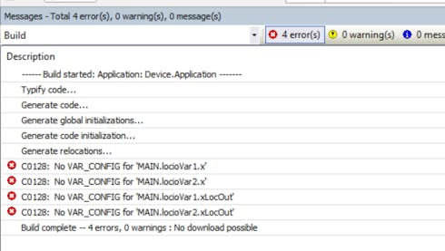

When I try to compile the program now I get the error that there is no VAR_CONFIG for the variables with incomplete address.

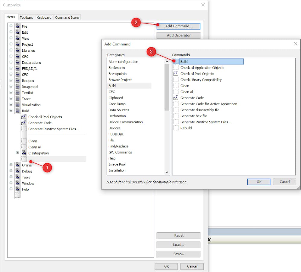

Workaround: Add the "build" only button to the menue again.

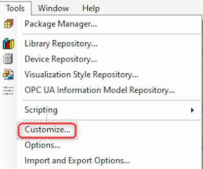

  • open customize dialog unter Tools
  • open Build tree and select an empty node
  • press "Add Command"
  • Select Build
  • press Ok
After this the build only button is available again and the descriped procedure works.
