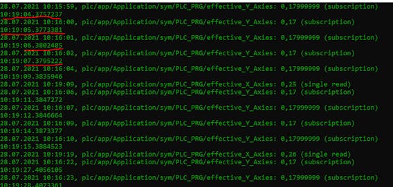

I was wondering why my DataLayer Node seem to be updated every second (see Screenshoot) , since I read from a node created inside my PLC Application. The PLC App itself has a cyclical time of 200ms, the connected device is an IFM IO-Linkmaster with ethercat interface. The Ethercatmaster is configured with a cyclical time of 200ms as well.
As far as I can tell the values should be updated more frequently, so why do they seem to be updated in a cyclical time of 1 second?ย

Just found out there is a publishInterval property with 1s.
