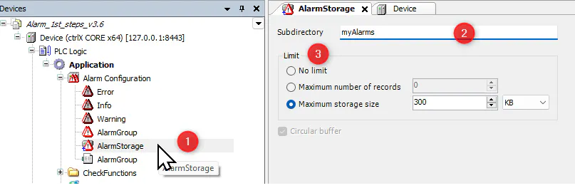

When you are talking for PLC alarms, here are the settings:
  • Select (1) AlarmStorage
  • (2) You can provide a subfolder of the PLC folder on internal storage where the SQLITE DB with alarm is stored
  • (3) You can limit the DB by "number of records" or "max. storage size"

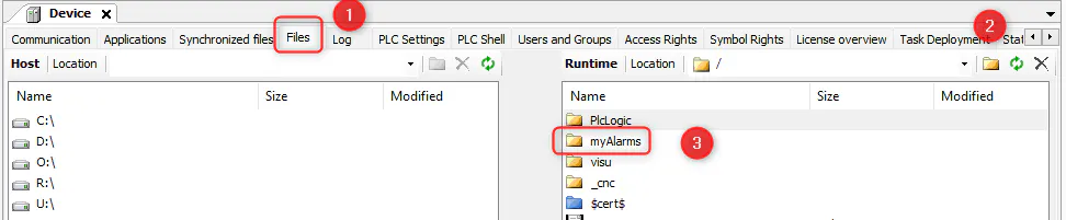

To view the files:
  • Run PLC program and create some alarms
  • Right click "Device..." in project tree & select "Communication settings"
  • Select tab "Files" (1), press Refresh icon (2)
  • Double click folder "myAlarms" to display its content
  • Trend recording has the same limit settings as the alarms
