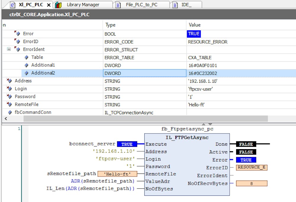

IL_FTPGetAsync:  "sRemotefile_Path was originally configured as "text.txt", which is the target file from ftp server. the value get replaced with fee character from the targetted file as shown in the below image
The error description says "Target buffer too small for file to be transferred". How can i fix it?

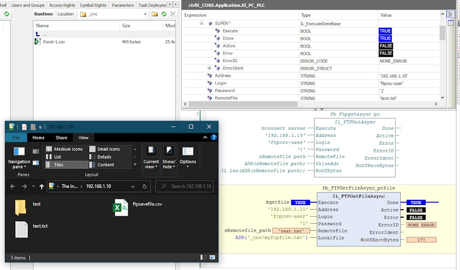

IL_FTPGetFileAsync: FB successfully completed the sequence, But did not retrived the targetted by to the path configured under Local file.
Could some one clarify, How can i successfully retrive the file from the ftpserver configured in my windows to my ctrlX core.

Hello Rathinavel
the difference between both FB's is:
  • IL_FtpGetAsync: Retrieves the content and stores it into a variable.
    You have to provide a variable where the data is stored, but you provide the file name variable (that's wrong).
    Expecting that you read a string variable, you define e.g.
       strData: STRING(1000);
       ValueAdr := ADR(strData);
       NoOfBytes := SizeOf(strData)

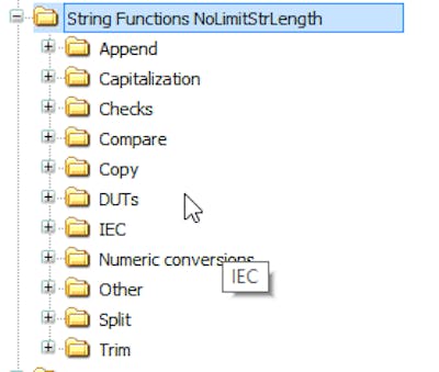

       Keep in mind, that the standard string function can only handle strings up to a length of 255 char. => Use string functions of library CXA_Utilities ofolder String Functions NoLimitStrLength
  • IL_FtpGetFileAsync: Retrieves the content and stores it into a file.
    When the FB executes successful, search the file in the active solution path of the PLC. Use either the file browser of PLC engineering or IDE app.
