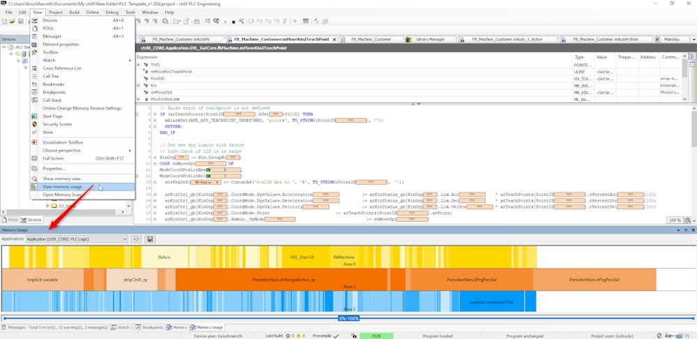

There is also the possibility to show the internal memory usage of your PLC program:
