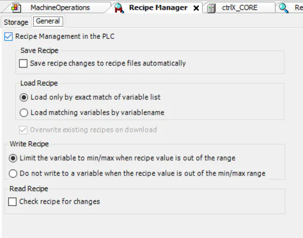

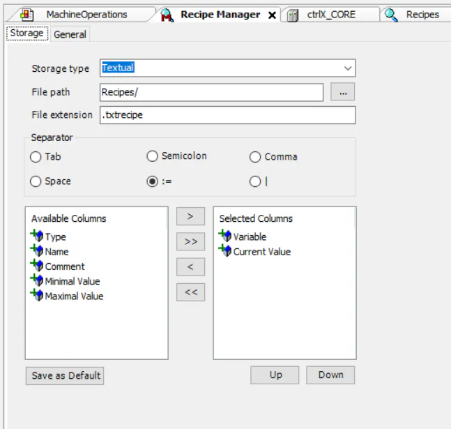

I am working on a project that requires the Recipe Manager. I currently have the Recipe Manager set to these settings.

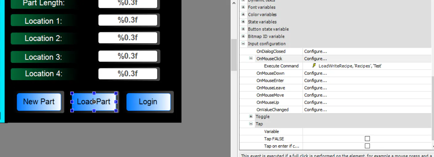

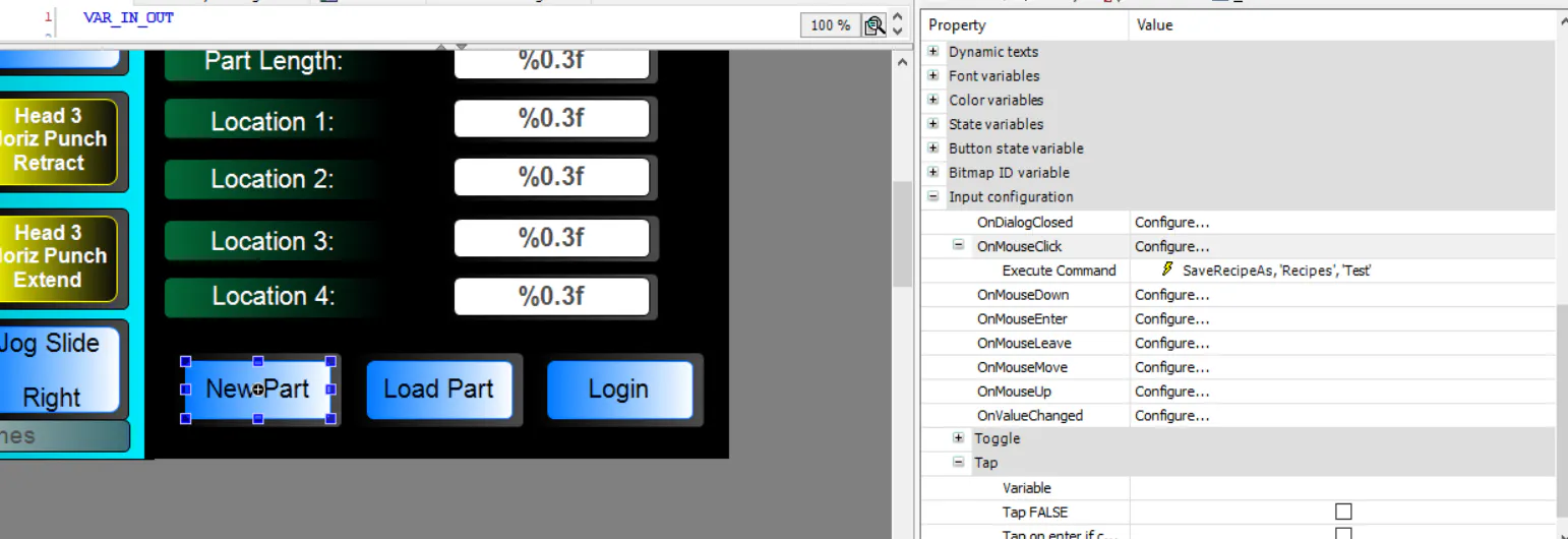

The two buttons on my visualization are configured with the SaveRecipeAs command and the LoadWriteRecipe command.

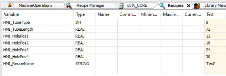

My recipe already has an example part as shown below.
When I go online with the project and click the 'New Part' button, it does nothing at all. Same as the 'Load Part' button.

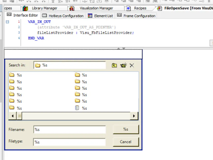

The visualization should pop up with this screen so I can save it to the ctrlX core.
