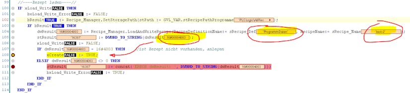

After OFF/ON of ctrlX existing recipes are NOT found. RecipeManager always has result 16#4003
With this result a new recipe is created.
In this example:
A recipe located in: PLCLogic\AllRecipes\Programme
with name: test-2.ProgrammDaten.prg
should be loaded.

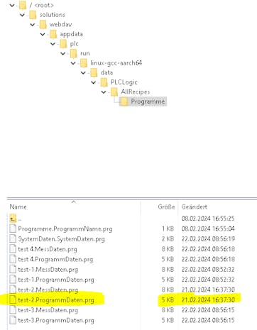

This program exists on ctrlX:
RecipeManager says it doesn't exist and creates a new one with that name.

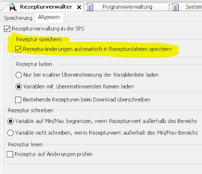

Now, the issue that during runtime created recipes are not known anymore after OFF/ON (they are lost) isĀ attributable to this setting:
Setting was lost during converting v1.20 -- v2.04
In recipe manager:
If not activated, during runtime created recipes are lost after OFF/ON or restart.
If activated during runtime created recipes are saved and can be used after OFF/ON or restart.

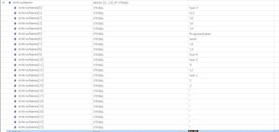

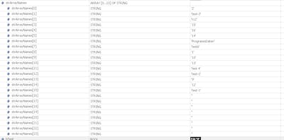

Taking a look to "Recipe_Manager.GetRecipeNames"
Before OFF/ON
After OFF/ON:
