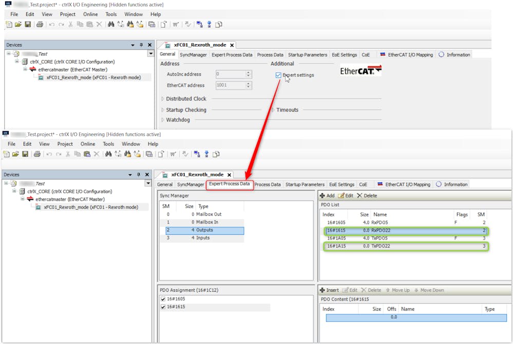

If you need the data cyclically you have to extend the settings of the EtherCat master. Enable the expert settings and extend the PDO22 part.

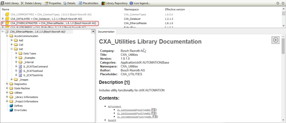

If just need the data from time to time please use the acyclic communicaion CoE read function blocks in the PLC:
