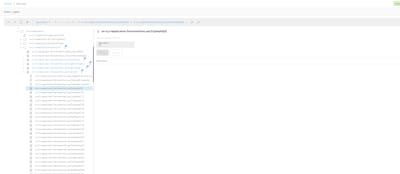

Could you add a screenshot of the metadata of the arrays head element in the data layer? There you see which data type is used and what can be done (read,write...) to this node.
