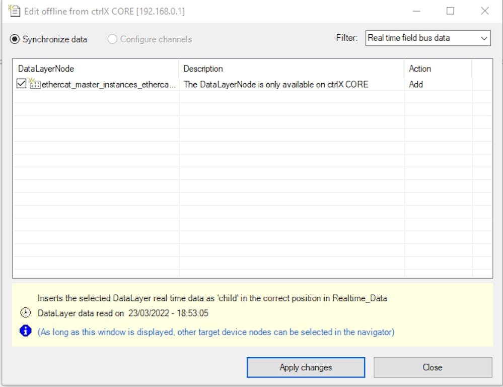

I am supporting a customer who is using a 3rd party EtherCAT IO device with ctrlX core. We have encountered probelms while importing the IOs in the PLC project.
PLC and ctrlx main release 1.12
He followed the "Wago HOW-TO" here there are the main step done:

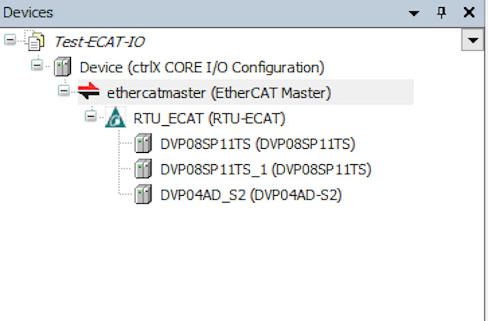

Importing the XML, scan and add the right modules manually and then download

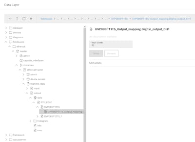

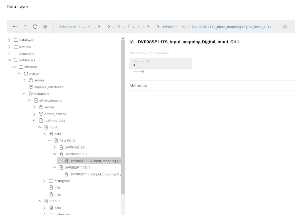

The data is then present in the datalayer, is possible to force the Outputs and read the inputs "manually".

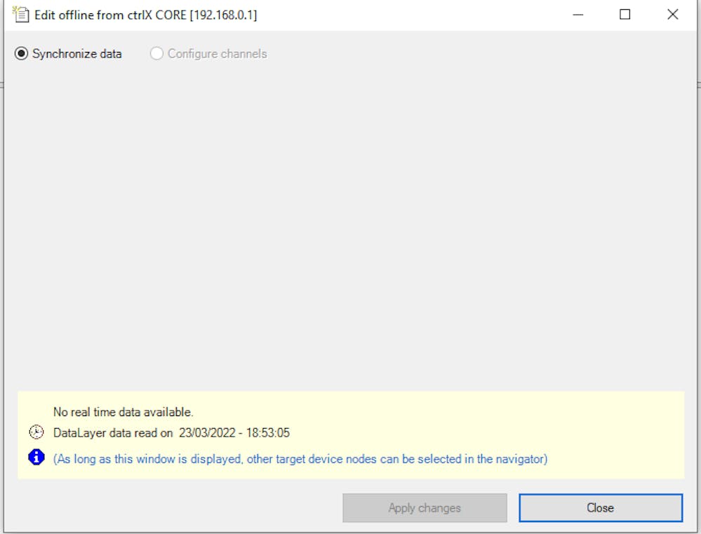

Following the Wago guide again the procedure got stuck here:
Clicking the apply change button there is no possibility to import the IOs.
Is there some step missing, some error or in case some "workaround"? to avoid the problem?

Problem SOLVED!! The problem is probably a bug in the ctrlX works PLC engineering 1.12.2
With the 1.12.4 worked one shot.
