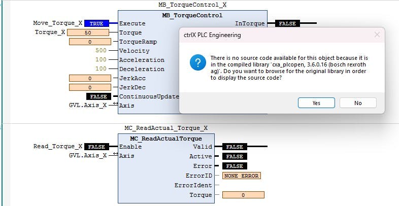

Hi guys,
I am using PLC Open Lib V3.6 for motion control.
A problem occurs whenever I try to write values and run the FBs related to Torque using PLC Open 3.6. Other FBs work fine, like V2.6.
It showed the following notice regarding the source code of the library. Whether I choose yes/no, PLC Engineering still forces me to log out and trigger the PLC exception. Is this an error in V3.6, or is there any further setup required?
I tried to turn off the notice from Tool -> Option -> Library, but it is not possible.
Thank you so much.
An update to this topic:
The problem will be fixed in the upcoming release 3.6.3 planned mid of October and also in version 4.4 planned beginning of December.
