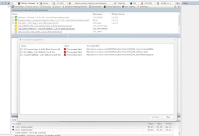

I am getting several errors on my PLC program that was written. It used to work until I updated my libraries. The errors that I am getting is related to 3 libraries that does not want to download. Please see screeshot below.ย
When going to "Download Missing Libraries", there are 3 Libraries missing. When trying to download them I get an error that the download has failed.

CXA.... libraries are installed when you install ctrlX WORKS, they are not downloadable from Codesys.
You may also check the Placeholder and change the version if you upgraded to a newer, this version of the library is maybe replaced.
If they are missing, try to uninstall and reinstall your ctrlX WORKS.
