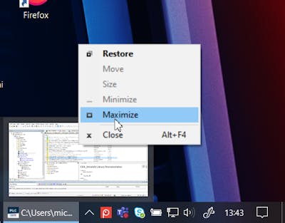

Having a strange issue, I can open my PLC engineering app, it starts up without any errors, but I can't get the window to show.
My I/O and Drives apps open and show, but my PLC window does not show. I can see it is open on my tasks bar. I know it is working because if I log into an existing program it shows the window to "load from PC or CORE?".
Is this a known issue?
Sometimes the window is kind of hidden because of several monitors were used and window "opens" on one not connected. You can simply do a right click on the preview window in the taskbar and choose maximize:
maximize tab from taskbar
