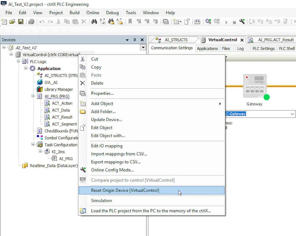

This can happen if there is a corrupt application on the system that cannot be overwritten. Please do a Reset Origin of the device, to delete the corrupted files and do a new download:
