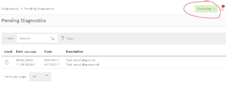

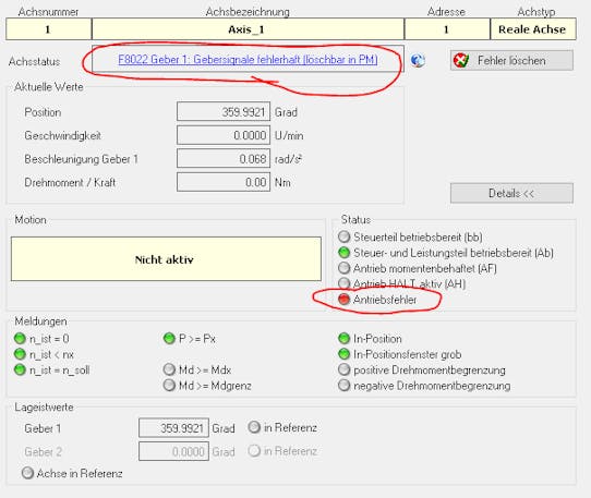

In ctrlX Drive there is the failure:

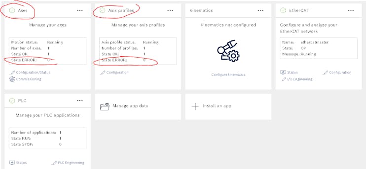

At the same time, in PLC, AxisInfertace, there is NO error:
No error in ctrlX Core
No way to do any reaction to this issue. Any ideas?
Update:ย
the behaviour will be changed from version 2.06 (RM24.03) on.
