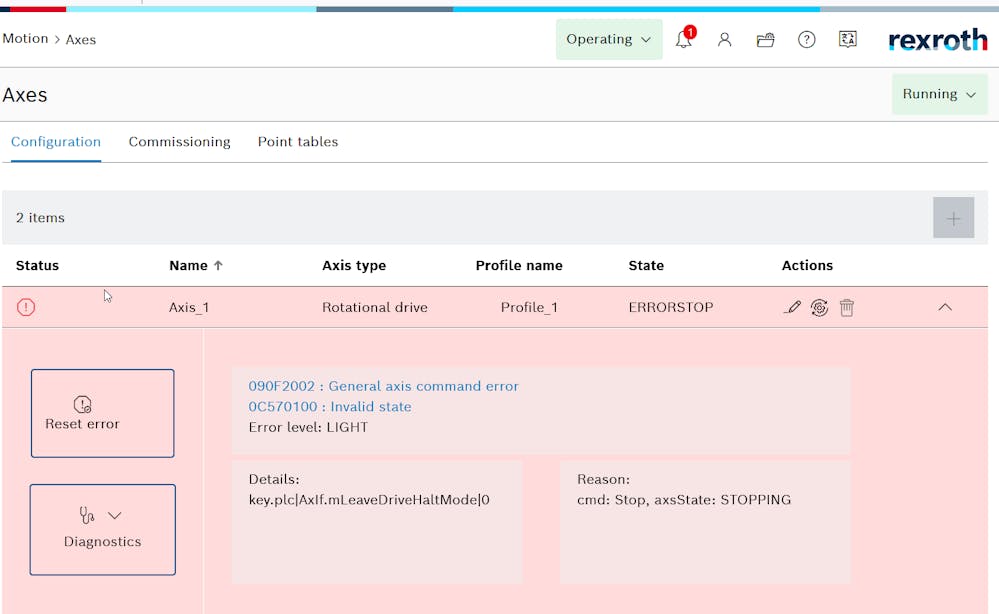

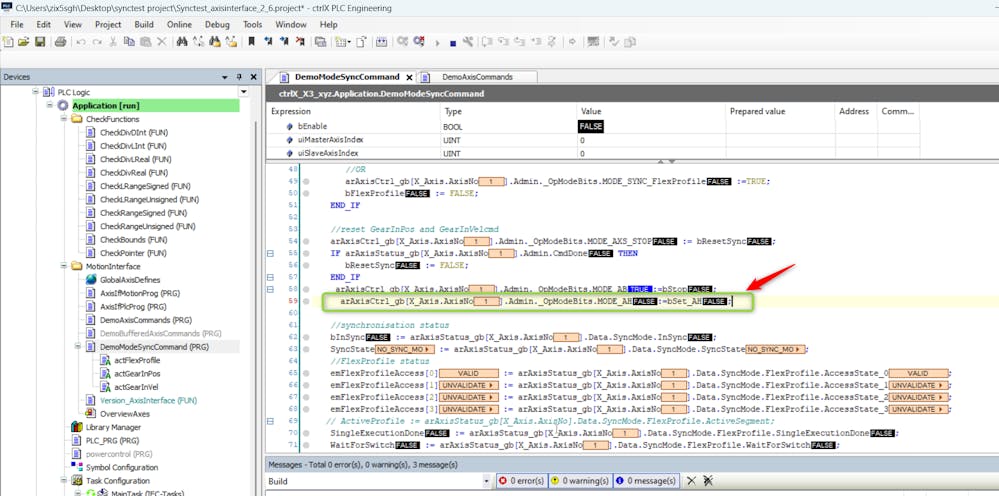

I used the Axisinterface modular for test. The core is  'X3 and drive is ctrlx drive (xcs)'.
The axie can  execute the position moving or velocity moving normally. But everytime when leave the 'ModeAH' command, the error appeared, meanwhile the servo stayed in AF state. The error can be reset. But why this error appeared? How to solve the problem?
Pls refer the pics for details.

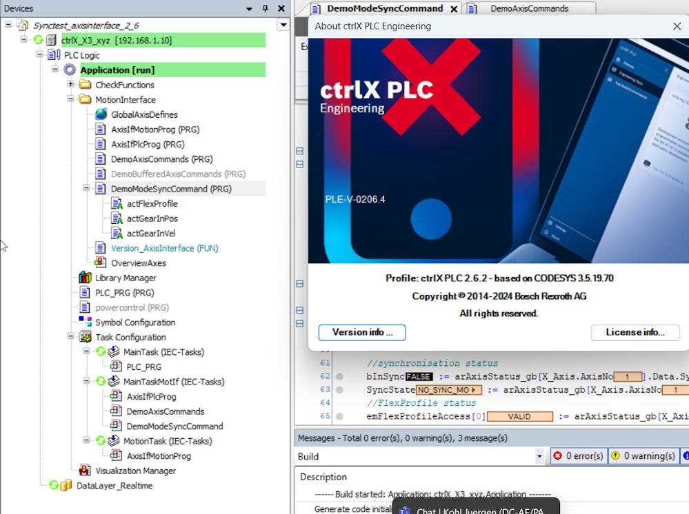

As there are several improvements made for such errors in the latest version please use the current release version of the ctrlX PLC Engineering 2.6.5 (including CXA_MotionInterface and CXA_MotionInterfaceUser version 2.6.1.10) as well as ctrlX MOTION app 2.6.6 and check again.
