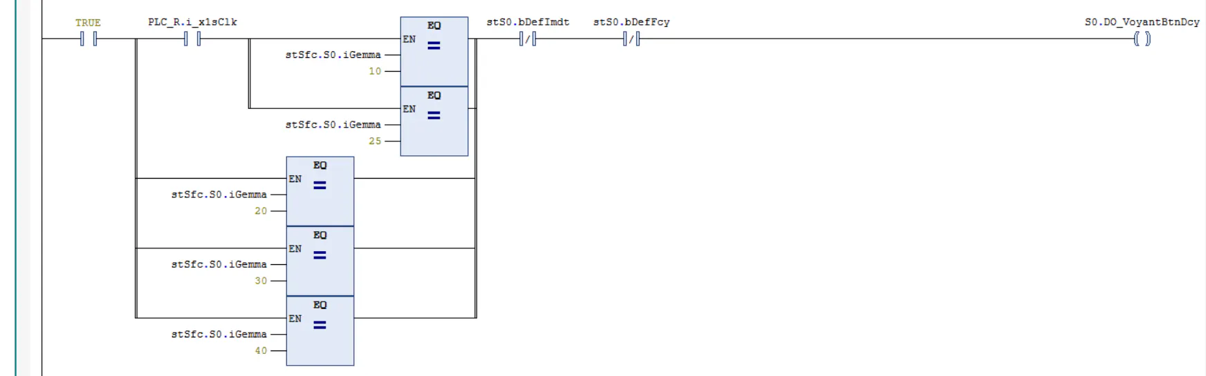

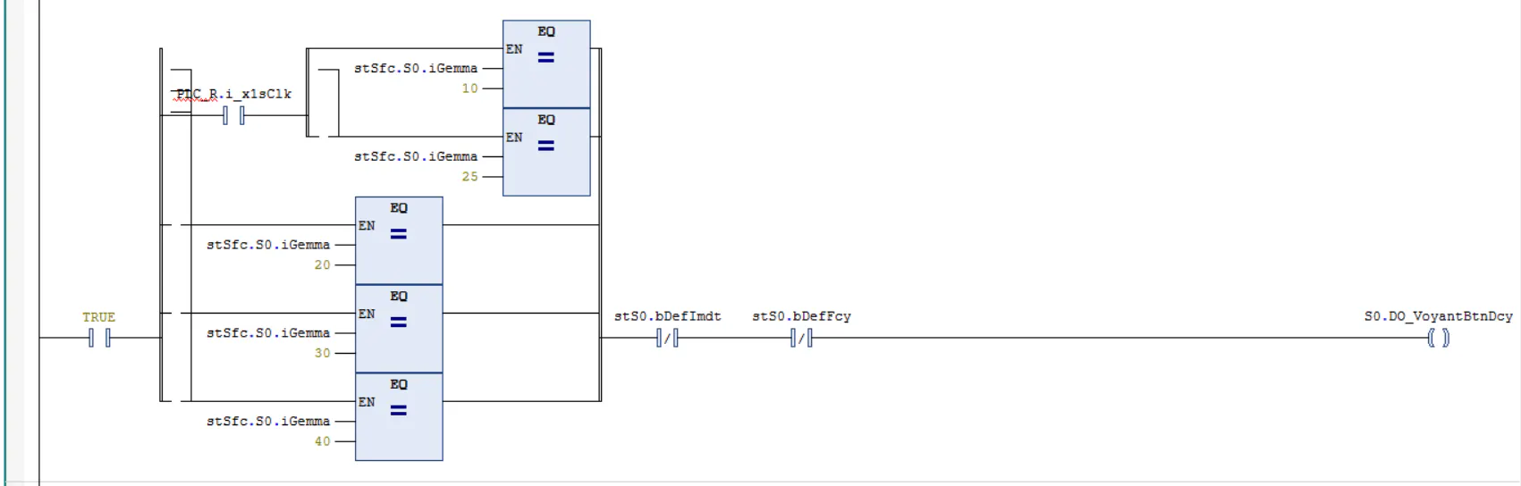

Using the pre-release of ctrlX PLC Engineering V4.6.0 which is based on Codesys 3.5.21.50, I noticed there is a bug when trying to use parallel branches on the LD editor with "box" (such as EQ comparison function):
The picture above comes from a PLC open XML import which should give this result (Tested with another Codesys version) :
By looking at Codesys release notes, I noticed there was a change done on Codesys 3.5SP21 to improve parallel branches on the LD editor Cf slide 10
However, I noticed that this bug is now fixed in Codesys 3.5SP22 (checked with 3.5.22.0 and 3.5.22.20).
Is there any chance the final version of ctrlX PLC Engineering V4.6 include a version 3.5SP22 of Codesys that fix this bug as it currently makes the LD editor pretty much not usable for anything else than contacts and coils ?

Hi LoicG ,
The bug may be fixed by installing the Codesys AddOn "CODESYS LD FBD 4.7.0.0.package".
