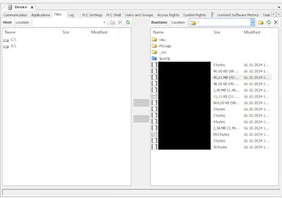

I want to determine how much internal memory my PLC application is using on the ctrlX. While I can view the size of each file by accessing Device -> Files:
I would like to know the total memory occupied by all the PLC files.

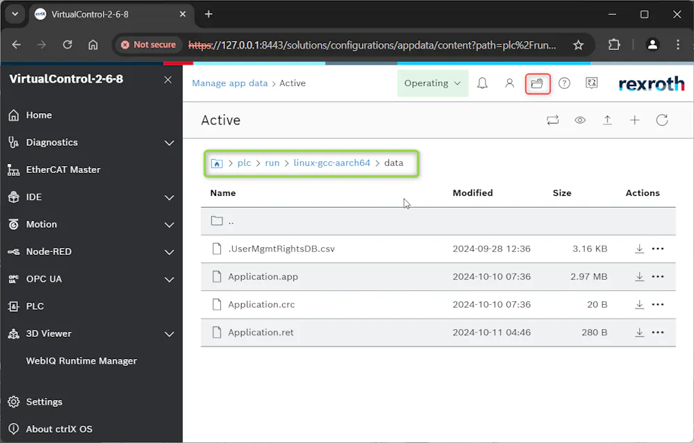

The working directory of the PLC is in the active configuration an accessible via the ctrlX OS web UI or also REST:
for ctrlX CORE X3: plc -> run -> linux-gcc-aarch64 -> data
for ctrlX OS, ctrlX CORE X5 + X7: plc -> run -> linux-gcc-x64 ->data
ctrlX OS web UI - PLC working directory
The path on the ctrlX OS file system is:
/var/snap/rexroth-automationcore/common/solutions/activeConfiguration/plc...
or /var/snap/rexroth-solutions/common/solutions/activeConfiguration/plc...
