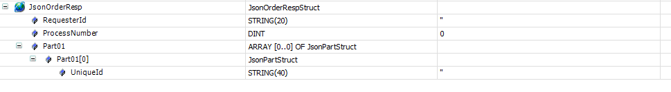

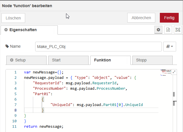

I want to write a more complex JSON object with Node-Red to the DataLayer to handle it in the PLC. The objects contains one or more arrays within other objects.
I found a running example how to write a simple object to the DataLayer here: https://github.com/boschrexroth/node-red-contrib-ctrlx-automation/blob/master/doc/EXAMPLES.md#monitor-and-handle-a-struct-plc-variable-strstruct

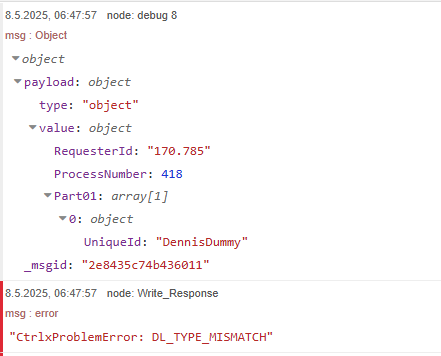

If I add an array or other object inside the main object and write it to the DataLayer, I will always receive a DL_TYPE_MISMATCH...
Is it possible to write such data to the DataLayer with the DataLayerRequest-Node?

  • There seems to be a problem when more then one array is in a PLC structure. Then the provided node in the data layer does not include any data but only child nodes.
  • When reading the node from the data layer via Node-RED the names of the arrays are not visible.
