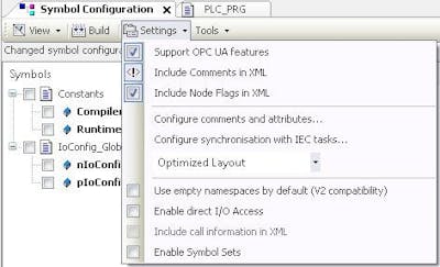

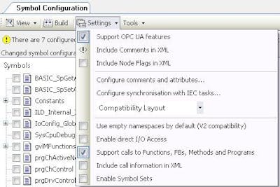

In IndraWorks I used SymbolConfiguration option "Support calls to Function, FB..."
But I can't find it in PLC Engineering
What is the best way to achieve this?
