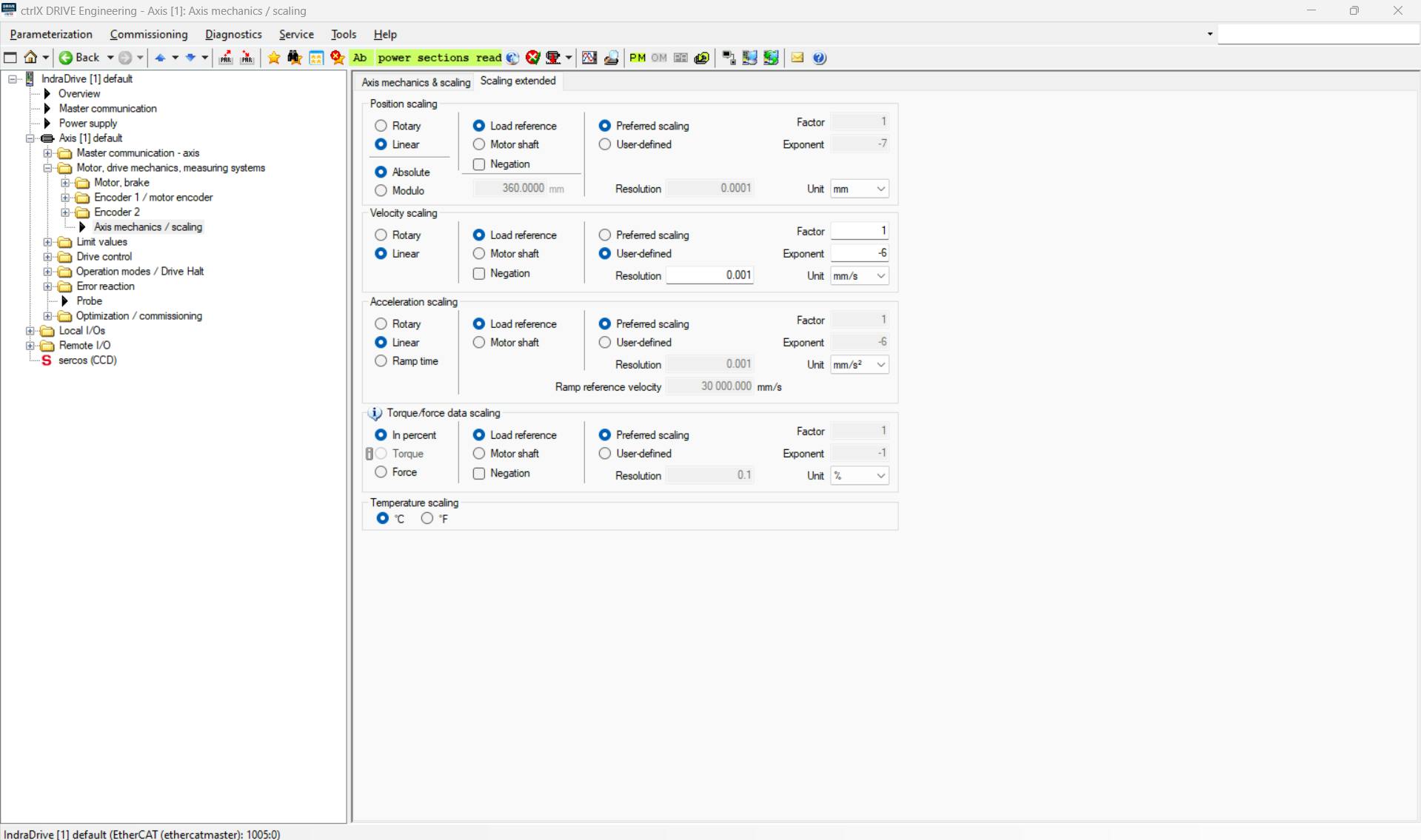

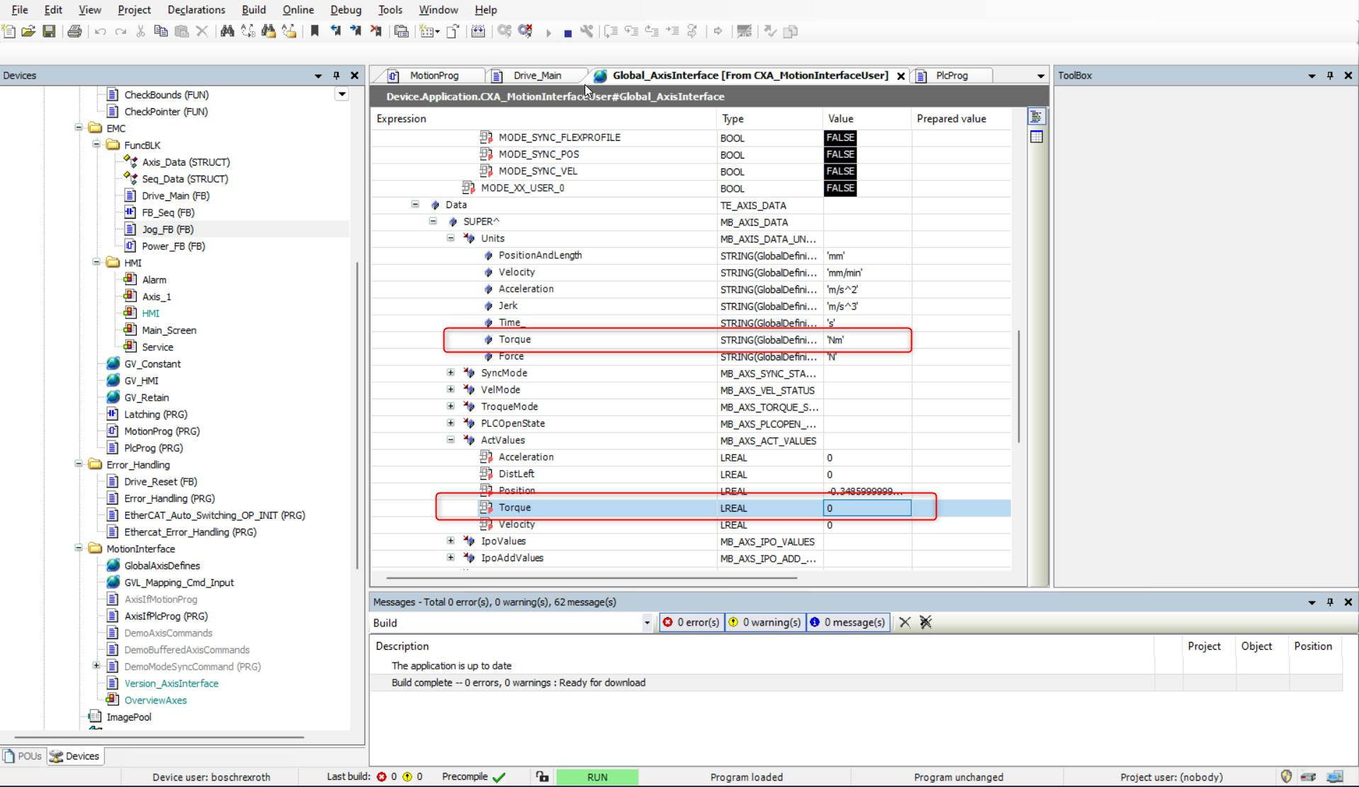

I am reading from S-0-0084, Torque/force feedback value.

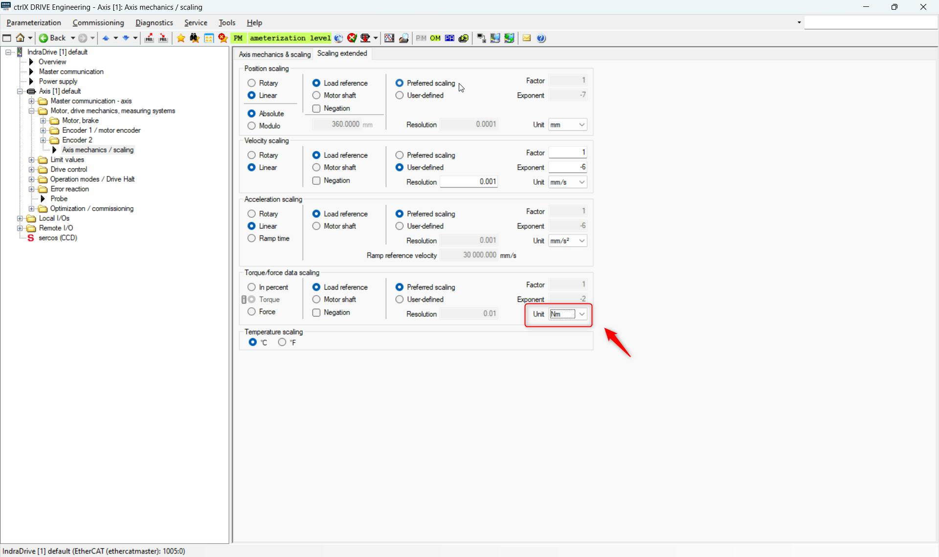

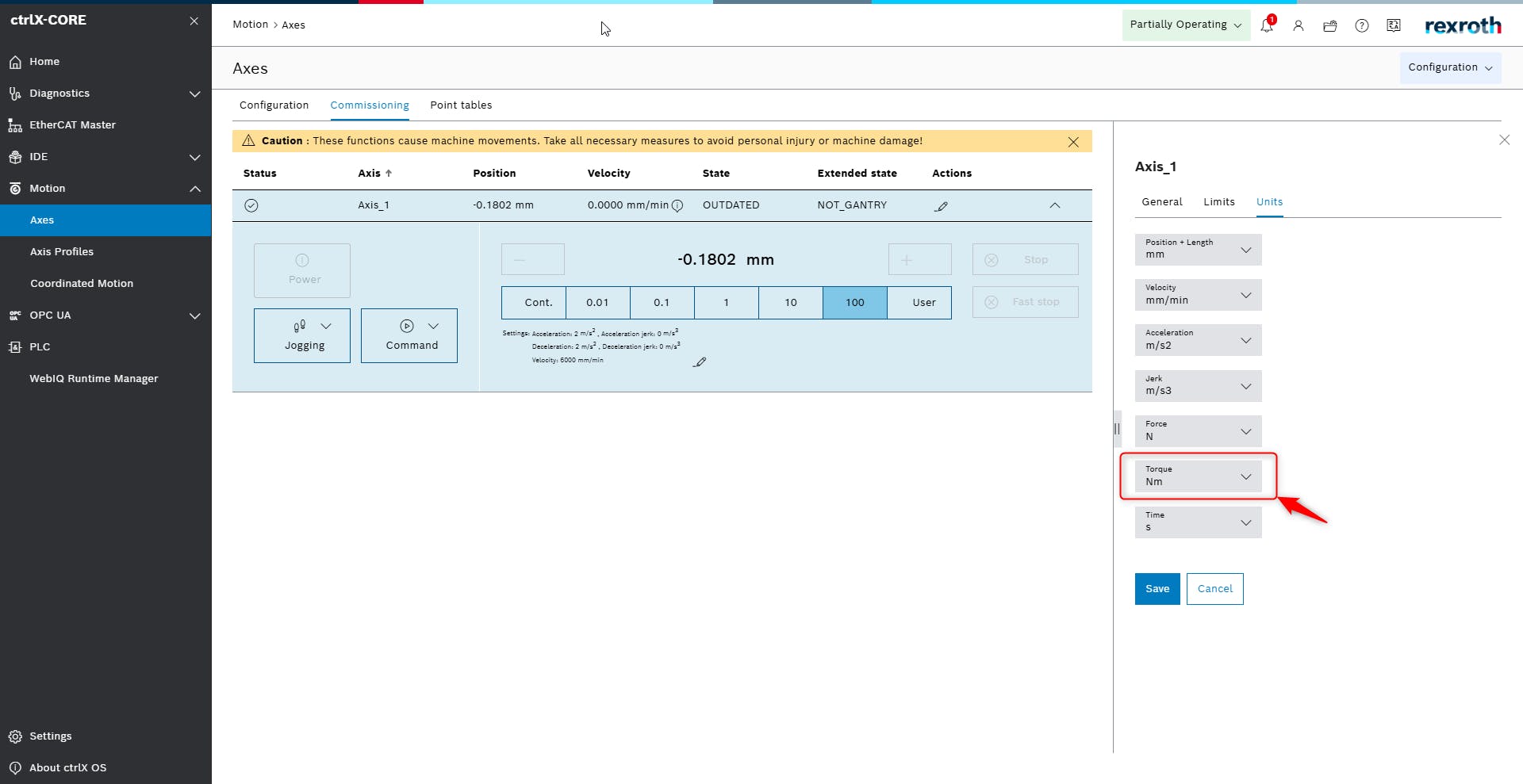

When i change the scaling unit to Nm
Motion App Torque unit to Nm.

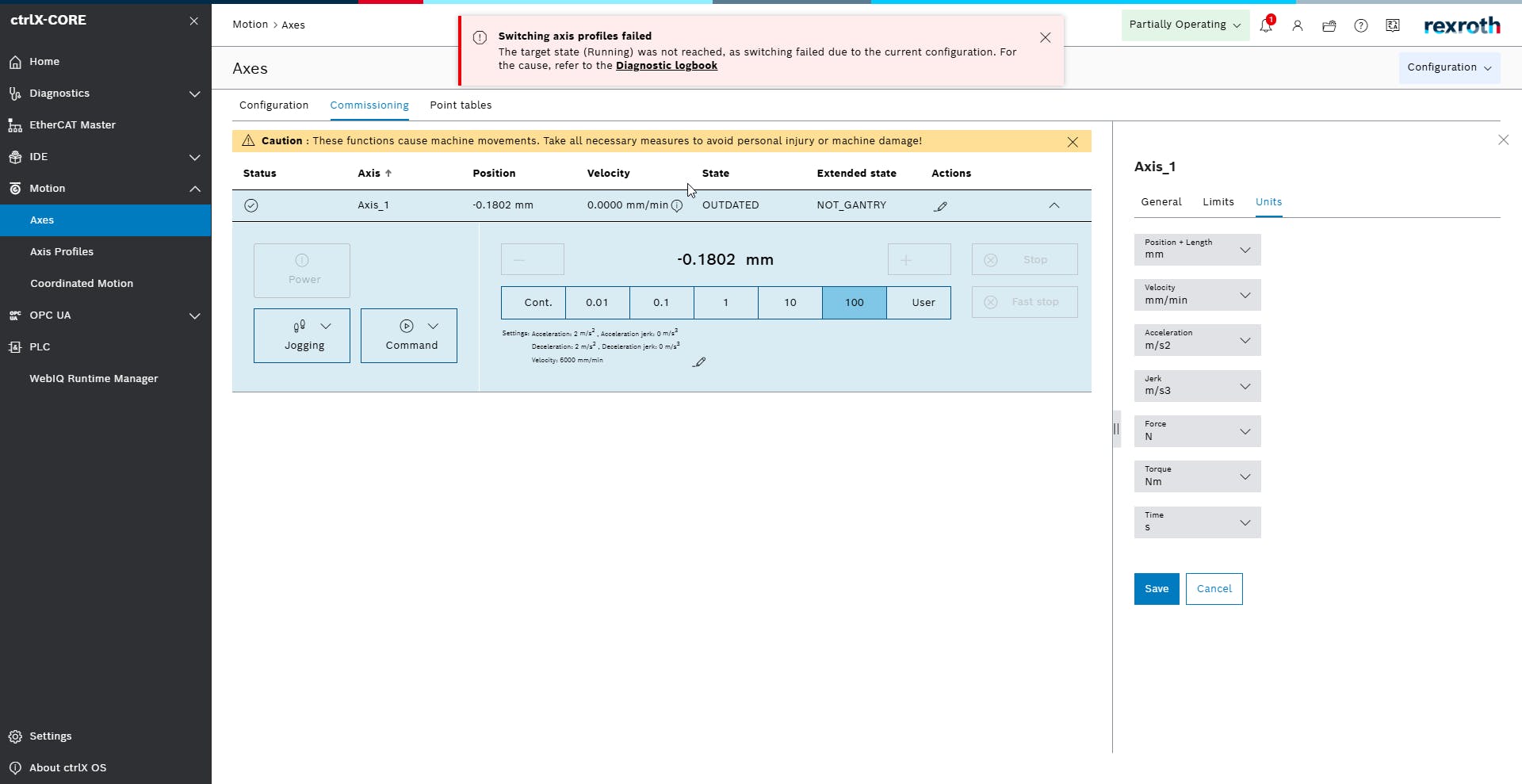

I will get switching axis profile failed.
If i switched to torque scaling to % is good.
Does anyone know the formula to convert Torque unit % to Nm?
